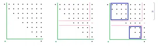

To prove the determinant formula, look at the matrix $A+tE_{ij}$: enter image description here
The green line are the $1$'s on the diagonal and the green dot has coefficient $t$. The white is zero and the grey is mess. Its determinant is the same as the determinant of the small red square's. The red square is zoomed in to on the left:
enter image description here The term in the determinant sum not including the green dot is $1$. The term involving it is $(-1)^{i+j} t \det T^{ij}$, where $T^{ij}$ is the matrix with the green column and row removed. Calculate $\det T^{ij}$ by considering which row of the last column (the pink dot) is summed over: $$\det T^{i,j}=\pm \binom{j-1}{i-1} \pm \cdots \pm \binom{j-1}{i-1+n}\det (T^{i,n+i})\pm \cdots \pm \binom{j-1}{j-2}\det (T^{i,j-1})$$ since the lower blue box has determinant $1$, and the upper, $\det (T^{i,n+i})$. By induction, $$\det T^{i,j}=\pm \binom{j-1}{i-1} \pm \cdots \pm \binom{j-1}{i-1+n}\binom{i-1+n}{i-1}\pm \cdots \pm \binom{j-1}{j-2}\binom{j-2}{i-1}$$ But (after following the signs) this is just a sum of the form as in $(1)$, with a $\binom{j-1}{i-1}$ term missing! Thus $$\det T^{i,j}=\binom{j-1}{i-1}$$
