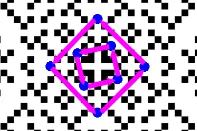

First, the symmetry of the Gaussian integers is square, while the symmetry of the Eisenstein integers is hexagonal.
For example, in the case of numbers with norm 13, we see that $(2 + 3i)i = -3 + 2i$, $(-3 + 2i)i = -2 - 3i$, $(-2 - 3i)i = 3 - 2i$ and one more multiplication by $i$ brings us right back to where we started. If you prefer to go clockwise instead, use $-i$ rather than $i$.
A much easier example is 7, with norm 49. We see that $7 \times i = 7i$, $(7i)i = -7$, $-7 \times i = -7i$ and one more multiplication by $i$ brings us right back to where we started.
Some multiplications of Gaussian integers by $i$
