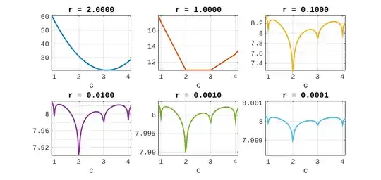

A numerical "evidence"
I consider the collection $\{1, 2, 2, 2, 3, 4, 5, 6\}$. In this case, the mean is $3.125$, the median is $2.5$ (between $2$ and $3$) and the mode is $2$.
Hereafter, I plot the function $f_r(c)$ for $r=2$ (mean) and $r=1$ (median). Also I plot the function for $r=0.1$, $r=0.01$, $r=0.001$ and $r=0.0001$.
