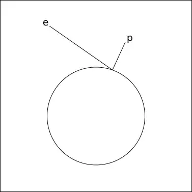

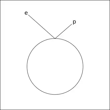

I have two points ($e$ and $p$) in a 2D space and I am trying to figure out where on the circle is the reflection of $p$ as seen from $e$. $$$$ $$$$ So the way I approached this is by looking for the vector from the center of the circle to the point, where the ray is reflected.

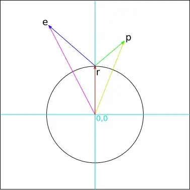

[For simplicity the circle's center is located at $\color{darkturquoise}{(0,0)}$ and it has a radius with unit length. The two points are represented by the vectors $\color{deeppink}{e}$ and $\color{gold}{p}$]
In the picture were looking for the vector $\color{red}{r}$, which coincides with the normal vector of the surface of the circle. So this vector has to fulfill 2 properties:
  1. $||\color{red}{r}|| = 1$
  2. The angle between $\color{red}{r}$ and $\color{green}{p-r}$ should be equal to the angle between $\color{blue}{e-r}$ and $\color{red}{r}$.
The equation for the fist property is pretty straight forward. For the second property I came up with the following equation: $$\Bigg|\Bigg|\frac{\color{blue}{e-r}}{||\color{blue}{e-r}||}\times\color{red}{r}\Bigg|\Bigg| = \Bigg|\Bigg|\color{red}{r}\times\frac{\color{green}{p-r}}{||\color{green}{p-r}||}\Bigg|\Bigg|\\ \frac{||(\color{blue}{e-r})\times\color{red}{r}||}{||\color{blue}{e-r}||} =\frac{||\color{red}{r}\times(\color{green}{p-r})||}{||\color{green}{p-r}||}\\ \frac{1}{||\color{blue}{e-r}||}\Big|\Big|(\color{deeppink}{e}\times\color{red}{r})-\big((-\color{red}{r})\times\color{red}{r}\big)\Big|\Big|= \frac{1}{||\color{green}{p-r}||}\Big|\Big|(\color{red}{r}\times\color{gold}{p})-\big(\color{red}{r}\times(-\color{red}{r})\big)\Big|\Big|\\ \frac{||\color{deeppink}{e}\times\color{red}{r}||}{||\color{blue}{e-r}||}= \frac{||\color{red}{r}\times\color{gold}{p}||}{||\color{green}{p-r}||}\\ \frac{||\color{green}{p-r}||}{||\color{blue}{e-r}||}= \frac{||\color{red}{r}\times\color{gold}{p}||}{||\color{deeppink}{e}\times\color{red}{r}||}\\ \frac{\sqrt{1 + ||\color{deeppink}{e}||^{2} - 2(\color{red}{r}\cdot\color{pink}{e})}}{\sqrt{1 + ||\color{gold}{p}||^{2} - 2(\color{red}{r}\cdot\color{gold}{p})}}= \frac{||\color{red}{r}\times\color{gold}{p}||}{||\color{deeppink}{e}\times\color{red}{r}||} $$ After that I use the fact that the cross product of 2 2D-Vectors has a single non-zero value and it determines the length of that cross product. $$ \frac{\sqrt{1 + ||\color{deeppink}{e}||^{2} - 2(\color{red}{r}_{1}\color{pink}{e}_{1} + \color{red}{r}_{2}\color{pink}{e}_{2})}}{\sqrt{1 + ||\color{gold}{p}||^{2} - 2(\color{red}{r}_{1}\color{gold}{p}_{1} + \color{red}{r}_{2}\color{gold}{p}_{2})}}= \frac{\color{red}{r}_{1}\color{gold}{p}_{2}-\color{red}{r}_{2}\color{gold}{p}_{1}}{\color{deeppink}{e}_{1}\color{red}{r}_{2}-\color{deeppink}{e}_{2}\color{red}{r}_{1}} $$ The left hand side is positive. I want both angles to have equal signs, because they are both in the same general direction as $\color{red}{r}$. This means that the right hand side is also positive. I square both sides to get rid of the roots on the left. $$ \frac{1 + ||\color{deeppink}{e}||^{2} - 2(\color{red}{r}_{1}\color{deeppink}{e}_{1} + \color{red}{r}_{2}\color{pink}{e}_{2})}{1 + ||\color{gold}{p}||^{2} - 2(\color{red}{r}_{1}\color{gold}{p}_{1} + \color{red}{r}_{2}\color{gold}{p}_{2})}= \frac{(\color{red}{r}_{1}\color{gold}{p}_{2}-\color{red}{r}_{2}\color{gold}{p}_{1})^{2}}{(\color{deeppink}{e}_{1}\color{red}{r}_{2}-\color{deeppink}{e}_{2}\color{red}{r}_{1})^{2}} $$ And this is as far as I can get. I don't think substituting $p_{2}$ with $\sqrt{1-p_{1}^2}$ will get me anywhere and also avoid it, since I am going to use that in a graphic application and I am trying to make as few calculations as possible.$$$$ Hope I explained the problem well enough and followed all conventions on this forum :) This is my first post here, so I accept any critique on it.

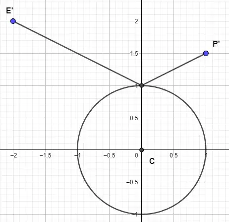

My idea is the following: If I rotate the points E and P around the circle center, then at some rotation angle $\alpha$ the point of reflection must be at the top of the circle, i.e. at the point $(0,1)$. And a way to know I have found the right rotation angle is if the slope of a line from E' to $(0,1)$ is the negative equal of the slope from P' to $(0,1)$. If I could find the angle in this way, then the point of reflection, in the original setup, would just be located at an angle of $\frac{\pi}{2} - \alpha$.
So, if we let $E=(a,b)$ and $P=(c,d)$, then the rotated position of $E$, call it $E'=(a_1, b_1)$, would be:$$a_1 = a \cos(\alpha)-b \sin(\alpha)$$ $$b_1 = a \sin(\alpha)+b \cos(\alpha)$$ Same goes for $P'=(c_1,d_1)$.
If the slopes from $E'$ and $P'$ to (0,1) are negative equals, then $$\frac{b_1-1}{a_1} = -\frac{d_1-1}{c_1}$$
Inserting the equations for $a_1, b_1,$ etc into the equation above and simplifying, we get $$(ac-bd)\sin(2\alpha) + (bc+ad) \cos(2\alpha)+(b+d) \sin(\alpha) -(a+c)\cos(\alpha) = 0$$ Not so easy to solve. But, I decided to try an approximation, simply substituting the trig functions with the first two terms of their Taylor series. These are quite accurate up to about $40^\circ$, which is enough as I'll later talk about.
Inserting the substitutions and simplifying we get $$-\frac{8e+g}{6}\alpha^3 + (\frac{h}{2}-2f)\alpha^2+(2e+g)\alpha+(f-h) = 0$$ where $e=(ac-bd), f=(bc+ad), g=(b+d)$ and $h=(a+c)$.
The roots of this cubic equation can now be found in the usual manner.
This was my first version of the program and it worked somewhat, but could be off by $5-6 ^\circ$ which is too much. The problem is that the approximations get inaccurate for large angles. The solution I found was to do an initial rotation of E and P such that the angle bisector of $\angle E'CP'$ is at $90^\circ$. This puts E and P close to where they should be and means the final adjustment angle to be found via the cubic equation, is small.
Based on the examples I've tried (and checked via GeoGebra drawings), the accuracy of the found angle is now close to 2 decimal places. An example below:
The input was $E=(-1,-1.5), P=(-2,2)$ and the ouput was the angle $-168.05^\circ$.
