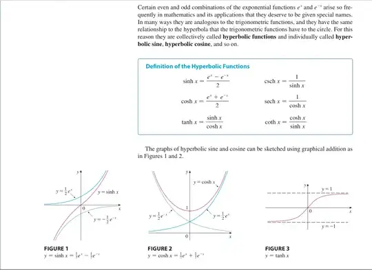

I don't really get why these hyperbolic functions are named after trig functions. Can someone enlighten me?
