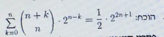

write the most simple algebraic proof you can, that means no integrals and no exponential generating functions if possible. I have tried to solve it for close to 2 hours. what I got to is almost nothing but here it is : $1/2 * \mathrm{2}^{2n+1}=\mathrm{2}^{2n}=\mathrm{4}^n=\mathrm{(2+2)}^n= \sum_{k=0}^n\binom{n}{k}\mathrm{2}^k\mathrm{2}^{n-k}=?\sum_{k=0}^n {n+k \choose n}\mathrm{2}^{n-k} $ and that's it. this is the first time I tried to use symbols so if something goes wrong, I am terribly sorry.
- 10,061
7Why write $\frac 12 \times 2^{2n+1}$? That seems an odd way to write $2^{2n}$, no? – lulu Feb 10 '18 at 01:05
Also, the problem in the text doesn't match the problem in the header so... – lulu Feb 10 '18 at 01:10
Have you tried to prove this by induction on $n?$ I haven't tried it myself, but it seems like a possible line of attack. – saulspatz Feb 10 '18 at 01:11
they want me to prove it combinatorially after the algebraic proof. I assumed it was easier to do that proof with it written this way. – Mohammad Amer Feb 10 '18 at 01:11
@lulu fixed the header. haven't tried induction, will do now. – Mohammad Amer Feb 10 '18 at 01:13
If they want you to prove it combinatorially, have you considered what either side of the equation could be counting? – Steven Stadnicki Feb 10 '18 at 01:33
@StevenStadnicki I have. but I really want to solve it algebraically first. I thought it might be counting how many binary strings there are over length 2n. – Mohammad Amer Feb 10 '18 at 01:35
