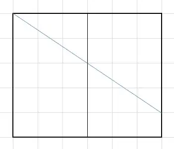

I have a rectangle made up of 30 identical squares (5 tall and 6 wide).
By only drawing two lines on the rectangle, split the rectangle into 4 parts where the areas are in the ratio 1:2:3:4.
How would one go around doing this? I tried for a solid hour or two; but to no avail.

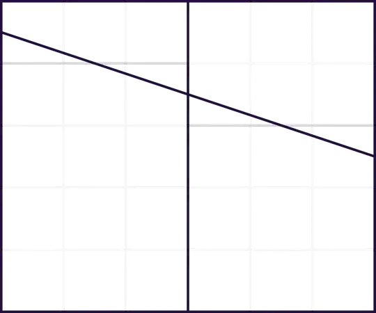

First, divide the rectangle equally on its long side, as suggested in the comments. In the left rectangle, mark the point that is $\frac45$ of the way up and centred horizontally; do the same for the right rectangle, but mark the point only $\frac35$ of the way up. Then draw the line connecting the two marked points. Since this line crosses the left and right edges of the whole rectangle, the four small triangles shown above (bounded between the purple and darker grey lines) have equal area, so the left rectangle is divided 1:4 and the right rectangle divided 2:3. Overall, the rectangle has been divided into four parts with ratio 1:2:3:4.

  • How did you arrive at this solution the first time around? – actinidia Feb 10 '18 at 06:07
  • @TiwaAina After the first cut, my approach was to find a point inside each resulting rectangle so that cuts through that point (provided they did not pass through the top and bottom edges) always divided the rectangle in the desired ratio. These points are the marked ones in the answer above. It remained to make the second cut pass through both these marked points. – Parcly Taxel Feb 10 '18 at 06:11

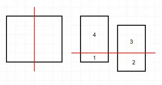

You need to move the two pieces into the right positions before you perform the second chop.
