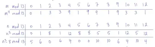

My question is how to express my solution to $m^4+8$ is not a cube of an integer if $13$ does not divide $m$ as a mathematical proof.
I understand that to prove by contradiction, the result is to be a cube of an integer:
\begin{align} m^4 + 8 & = n^3 \\ m^4 &= n^3 - 8 \\ \therefore m^4 &\equiv n^3-8\pmod{13}\\ \\ \end{align}
That equivalence is however impossible, because of the following table:enter image description here
We see that $m^4 \equiv n^3-8\pmod{13}$ can only occur when m $\equiv 0 \pmod{13}$ and n = 2, 5 or 6.
This shows that since $13$ can not divide $m$, $m^4+8$ is not a cube of an integer. I am now sure how to express this mathematically.
Any help would be appreciated!

    What you have done is perfectly OK. Possibly there might be an easier way to do it, I don't know about this. – David Feb 09 '18 at 05:35
    To be honest, I think your proof is already pretty “mathematical”. It’s a proof by cases, which is common enough. – G Tony Jacobs Feb 09 '18 at 05:38
Your method is perfectly fine for this. Just for fun, I'm giving an alternative method in which you can make do with only a table of squares mod 13.
n     0  1  2  3  4  5  6  7  8  9 10 11 12
n^2   0  1  4  9  3 12 10 10 12  3  9  4  1
$$m^4+8 \equiv n^3 \mod 13\\ (m^4+8)^4 \equiv n^{12} \mod 13$$ From Fermat's little theorem we know that $n^{12}\equiv0,1 \mod 13$, so we then get: $$(m^4+8)^4 \equiv 0,1 \mod 13\\ (m^4+8)^2 \equiv 0,1,12 \mod 13\\ m^4+8 \equiv 0,1,5,8,12 \mod 13\\ m^4 \equiv 0,4,5,6,10 \mod 13$$ Note that $5$ and $6$ are not squares, so they are certainly not fourth powers. $$m^4 \equiv 0,4,10 \mod 13\\ m^2 \equiv 0,2,6,7,11 \mod 13$$ Note that the only one of these that is a square is $0$ so we are just left with $$m^2 \equiv 0 \mod 13\\ m \equiv 0 \mod 13$$
