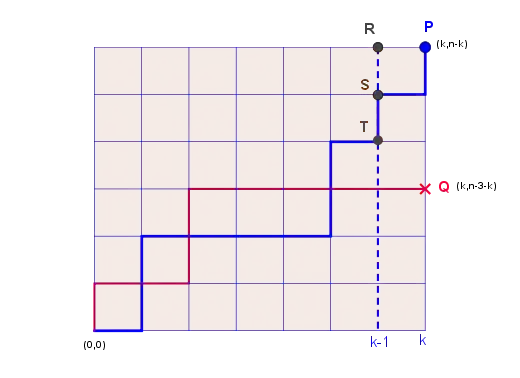

Combinatorial proof without words:
              enter image description here \begin{align*} \hline \end{align*}
Or with some words:
We consider the lattice paths of length $n$ from $(0,0)$ to $(k,n-k)$ consisting of $(1,0)$-steps and $(0,1)$-steps only. The number of these paths is $$\binom{n}{k}$$ since we have to choose precisely $k$ $(1,0)$-steps out of $n$ steps.
The identity \begin{align*} \underbrace{\binom{n}{k}}_{\color{blue}{\textbf{P}}} -\underbrace{\binom{n-3}{k}}_{\color{red}{\textbf{Q}}} =\underbrace{\binom{n-1}{k-1}}_{\textbf{R}} + \underbrace{\binom{n-2}{k-1}}_{\textbf{S}} + \underbrace{\binom{n-3}{k-1}}_{\textbf{T}} \end{align*} is valid, since
  • the number of paths from $(0,0)$ to $\color{blue}{P=(k,n-k)}$ which do not pass $\color{red}{Q=(k,n-3-k)}$
is the same as the number of paths from $(0,0)$ which go either
  • to $R=(k-1,n-k)$
  • or $S=(k-1,n-1-k)$
  • or $T=(k-1,n-2-k)$.
Note: Each of the paths to $R,S,T$ can be uniquely extended to $P$ via a $(1,0)$-step followed by zero, one or two $(0,1)$ steps.
