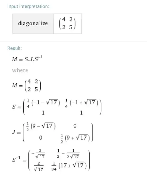

The original idea by me is to diagonalize such quadratic form. The result of diagonalization of the quadratic form $4x^2+4xy+5y^2$ is: enter image description here
However, the eigenvalues are very ugly. How to do the rest step to compute the integral? Is there an easy way?
