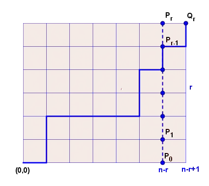

A combinatorial proof based upon lattice paths.
The number of lattice paths of length $n+1$ from $(0,0)$ to $Q_k=(n-k+1,k)$ consisting of $(1,0)$-steps and $(0,1)$-steps is $$\binom{n+1}{n-k+1}=\binom{n+1}{k}$$ since we have to choose precisely $n-k+1$ $(1,0)$-steps from a total of $n+1$ steps.
We observe that each path which goes from $(0,0)$ to $Q_k$ crosses the vertical line $x=n-k$. We can therefore partition all $\binom{n+1}{k}$ paths according to points $P_j=(n-k,j), 0\leq j\leq k$ which are followed by a horizontal step to $(n-k+1,j)$ and the vertical steps which lead to $Q_k$.
Since there are precisely $\binom{n-k+j}{j}$ paths from $(0,0)$ to $P_j$ the number of all paths from $(0,0)$ to $Q_r=(n-k+1,k)$ is \begin{align*} \color{blue}{\binom{n+1}{k}=\binom{n}{k}+\binom{n-1}{k-1}+\cdots+\binom{n-k}{0}} \end{align*}
