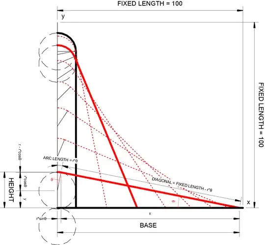

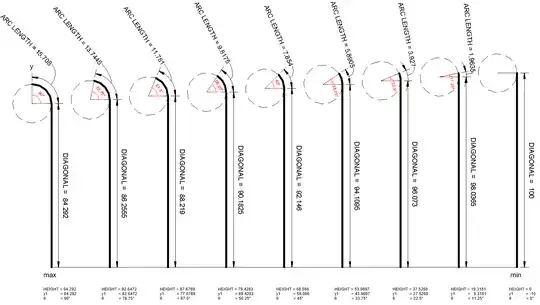

I am ultimately trying to solve this diagram: Get $x$ when given $y$
Where the following constraints must be satisfied:
  1. The length of red lines ($ARC LENGTH + DIAGONAL$) must equal the $FIXED \ LENGTH$.
  2. As the $HEIGHT$ increases, the $BASE$ decreases.
  3. The maximum ${HEIGHT}$ is given by the equation: $$ HEIGHT_{max} = (FIXED\ LENGTH - r*\fracπ2) + r $$ at which point $${BASE}_{min} = r $$
  4. The minimum ${HEIGHT}$ is given by the equation: $$ HEIGHT_{min} = 0 $$ at which point $${BASE}_{max} = FIXED\ LENGTH$$
  5. The red lines must always start at $x=0$, rotate over a circle of radius $r$, and end at $y=0$ (it must always be attached to the $x-$ and $y-axis$).
  6. As such, $r$ and $FIXED\ LENGTH$ are constants
  7. $\theta$ is dependent on $y$ .

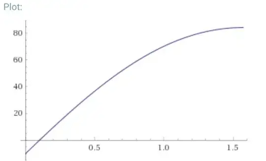

When $\theta$ is given, it is relatively easy to find $y$. For example for the cases:
$$ \begin{cases} y = variable\\ c = 100 \\ r = 10 \\ \theta = 0\ to\ \fracπ2 \end{cases} $$
This is a plot of all the possible values for $\theta$ and $y$.
