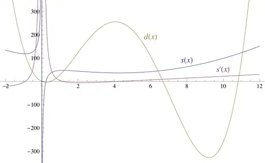

Since $A+B+C=\pi$, we have $$ \tan(A)\tan(B)\tan(C)=\tan(A)+\tan(B)+\tan(C)\tag1 $$ Letting $x=\tan(A)$, $y=\tan(B)$, and $z=\tan(C)$, our constraints become $$ x+y+z=xyz=9\tag2 $$ Solving for $y\ge z$ in terms of $x$, we get $$ y=\frac{x(9-x)+\sqrt{x^2(9-x)^2-36x}}{2x}\tag3 $$ and $$ z=\frac{x(9-x)-\sqrt{x^2(9-x)^2-36x}}{2x}\tag4 $$ Then, we get $$ \begin{align} s(x) &=x^2+y^2+z^2\\ &=\frac{3x^3-18x^2+81x-18}{2x}\tag5 \end{align} $$ and $$ s'(x)=3x-9+\frac9{x^2}\tag6 $$ and $$ s''(x)=3-\frac{18}{x^3}\tag7 $$ where we need $$ d(x)=x^2(9-x)^2-36x\ge0\tag8 $$ so that $y,z\in\mathbb{R}$. $d(x)\ge0$ on $$ (-\infty,0],[0.498040209888,6.678221141368],[10.823738648744,\infty)\tag9 $$ If any of $x,y,z\lt0$, since $xyz=9$, exactly two of $x,y,z\lt0$, but this would imply two obtuse angles. Thus, $x,y,z\gt0$. If $x\gt9$, then $y+z\lt0$. Therefore, we can only have $$ 0.49804020988787915596\le x\le6.6782211413676239727\tag{10} $$ enter image description here
Formula $(5)$ has one local maximum at $$ \begin{align} x&=1.1608894293161880136\\ x^2+y^2+z^2&=47.29396614720561963\tag{11} \end{align} $$ and one local minimum at $$ \begin{align} x&=4.2509798950560604220\\ x^2+y^2+z^2&=36.38970418700683168\tag{12} \end{align} $$ We also have the two edge cases $$ \begin{align} x&=0.49804020988787915596\\ x^2+y^2+z^2&=36.38970418700683168\tag{13} \end{align} $$ and $$ \begin{align} x&=6.6782211413676239727\\ x^2+y^2+z^2&=47.29396614720561963\tag{14} \end{align} $$ Therefore, under the conditions given, we have $$ \bbox[5px,border:2px solid #C0A000]{36.38970418700683168\le x^2+y^2+z^2\le47.29396614720561963}\tag{15} $$
