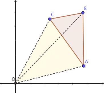

Things are a bit more interesting if the origin is exterior to $\triangle{ABC}$ as in the example illustrated below:
Observe that the first two triangles cover $\triangle{ABC}$, but they also include the excess yellow area of $\triangle{OAC}$. However, the latter’s vertices are traversed clockwise in the formula, so its area gets subtracted from the total, leaving only the area of $\triangle{ABC}$.
Traversing the vertices of $\triangle{ABC}$ clockwise reverses the orientation of each of the three sub-triangles, which in turn changes the sign of the determinant, so this also changes the sign of the total area without changing its magnitude.
