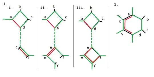

With the notation above the HC would be e.g. $adef\color{red}{ef}\dots yx \dots za$, so the $\color{grey}{cd}$-edge is missing. I found three possibilities that are PAINTed below. Let the edges of the HC be coloured in $\color{green}{green}$ and edges that introduce errors in $\color{red}{red}$. $\color{black}{Black}$ edges don't contribute to the case under investigation.
Figure 1: We can introduce two errors if we go directly from $a$ to $d$, thereby miss $bc$, and then:
  1. use backtracking along the HC $ad\dots ef\color{red}{ef}\dots yx$ $\scriptstyle \text{(this can happen at any edge along the HC)}$
  2. use backtracking aside the HC $ad\dots e\color{red}{xe}f\dots yx$ $\scriptstyle \text{(this also can happen everywhere on the HC)}$ or
  3. make a detour at a second square $ad\dots e\color{red}{xy}f\dots yx$ $\scriptstyle \text{(only here we need a 2nd square)}$.
EDIT For Figure 1)ii. I found another version without backtracking:
Let the part of the HC be $\dots abcd\dots ef \dots yx\dots$, so that there is another cycle part $C_{fy}$ joining $f$ and $y$. Then two errors can be introduced as follows:
  • make the usual shortcut at a square, missing the $bc$-edge
  • go from $e$ to $x$
  • walk along $C_{fy}$ in the opposite direction
  • again go from $e$ to $x$, which is traversed twice
You may think of backtracking as a $2$-cycle. This variant may also happen everywhere.
Figure 2: "$\color{blue}4$-$\color{goldenrod}2$-hexagon": Again the original HC $\underbrace{abcd}_{\color{blue}4} \dots \underbrace{yx}_{\color{goldenrod}2}$ is depicted in green. Two errors can be introduced by $a\color{red}{xy}d\dots yx$.
My question rephrased:
$\hskip1.3in$ Are these subgraphs the only ones to introduce two errors?
Some remarks:
  • In Figure 1 the vertices $d$ and $e$ don't need to be adjacent as indicated by the dashed line.
  • In both figures, I think (not sure) that I could have also chosen $yx$ at the end.
  • I tried to use the "$2$-$2$-$2$-hexagon" (where Hamilton runs through like $ab...cd...yx$, so without the $bc$-, $dy$- and $xa$-edges) without success
  • and sorry for the PAINT work (feel free to improve it!)...
.. and I'm pretty sure that the answer is no, see below...

Just to clarify, it seems like you want your deviation to result in an edge path still (no jumping from one vertex to another). Is that right? In fact, it seems you want a closed edge path, one that starts and stops at the same vertices.
When you introduce your first kind of error (missing two vertices completely), you have to remove three line segments, the ones going into, between, and out of the pair of points (call them $a$ and $b$). Removing these breaks the closed circuit into a single arc, whose end points must be connected by some new path to form a new closed circuit. Any such path will either:
  1. Go directly from $a$ to $b$, or
  2. Go through some even number of other points on the way to $b$ (even by bipartiteness).
In case 1, the three deleted edges and the new edge start and end at the same points, and so they form a simple closed curve separating the plane. So we get a square, possibly with part of the graph inside and part outside. I do not know if your conditions prevent this possibility. We then need to go through two vertices an extra time. So we can only do this by adding a new edge somewhere. We can either follow this new edge by its inverse, and continue onward (I.e. backtracking) or not. If not, call the vertex we labded at x. We must go over some subsequent edge to a point y. However, I believe your figure 3 is false, as x and y need not be connected by an edge of the Hamiltonian cycle. In any case, this can't go on forever, as we can't visit any other vertex twice, so we must return immediately to the place where we left off (f in your picture). As above, this does give a square, although it may be non-empty inside.
In case 2, our new path can only go through two other vertices, since otherwise we added too many errors. Thus, we must have a hexagon, although, again, some of the grah might be inside of the hexagon and some outside.
So, the only things not covered by your pictures are:
  1. The square/hexagon might contain parts of the graph inside and outside at the same time.
  2. The new edge added between x and y might not be an edge in the old Hamiltonian cycle.
This proof method should generalize easily, although I haven't thought it through. Adding twice as many errors either gives copies of the above errors, or octagon errors, etc. I may post more. Thanks for sharing your problem! Let me know if there are any problems in my analysis.

  • Brian, thanks for your answer, here are mine: Yes, the path should be closed (it was/is a cycle) and of the same length as the original HC. Not sure if this is called an edge path, but it sounds right. (i)But I don't want to remove/add edges to the graph. (ii)To admit the drawing are a little wrong since some of the vertices miss the cubic property (I will update it). (iii) Also "2 squares" doesn't really fit. I removed the $ex$/$fy$-edge(s) (see the post revisions), because you don't need them, to introduce two errors. – draks ... Dec 30 '12 at 15:54
  • (iv) How is Figure 3 false? When the original HC is $abcd..ef..yx$ and you have exactly these two 2 squares (here the subtitle is correct), you could introduce two errors if take the path $ad\dots e\color{red}{xy}f\dots xy$. Maybe a picture of yours would help. Thanks for your time so far... I will put some of my motivation in the next edit together with some more clarifications... – draks ... Dec 30 '12 at 15:58
  • Figure three isn't false, it just splits into two cases. The points x and y might not have a green edge between them; you can think of the path going into x, diving down and to the left and coming back up and to the right to y in a kind of "hairpin" turn. – Brian Rushton Dec 31 '12 at 13:18
  • What if the original path is abcd...ef...y...x and the new path is abcd...exyf...y...x? That's what I was saying;I should draw a picture, but I'm doing this n an iPad. – Brian Rushton Jan 02 '13 at 01:46
  • Where do you go from the second $y$? To $f$,$x$ or back to where you came from (call it $t$), but anyway you introduce more than two errors. Draw the picture by hand, make a photo and post that. – draks ... Jan 02 '13 at 19:00
  • Hey @brian seriously why not make a photo of your drawing and post that? It can't be worse than PAINT... – draks ... Jan 06 '13 at 21:07

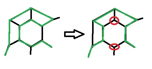

I think I found another way to miss two vertices: enter image description here
Combine this with, let's say backtracking or any other option to meet vertices twice from the question's figure 1 (edit: or the example below). I think is really different from the way above shown, since the vertices that are missing are not connected by an edge as above.
Let the 10-vertex-Hamiltonian path be $abcdefghij$, then the two error variant is 8 vertices long and may be written as $afghicdj$. It should be possible to extend the inner hexagon to larger structures by introducing additional edges into the outer squares.

Here's another example of how to meet two vertices twice: enter image description here
Let the part of the HC be $abcd$, then the path on the rhs is $abadcd$, where $a$ and $d$ are met twice. The difference to example 1.iii.(lower part) is the HC we start out with.
So the above shown are not the only onces...
