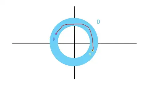

Let $D = \{ (x, y) \ | \ 1 \leq x^2 + y^2 \leq 2\}$ denote the disk.
Observe that for any two points $p, q$ in $D$ there exists a path (a continuous function) $\gamma : [0, 1] \to D$ such that $\gamma(0) = p$ and $\gamma(1) = q$. You only need to draw a picture like the one below to convince yourself of this fact. Note that the red line is the graph of the path $\gamma$.
Hence $D$ is path connected, and thus connected.
In general it is much easier to verify path-connectedness and then use that to prove connectedness, so where you can try and follow this approach.
