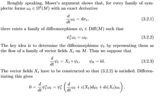

I've been reading McDuff's Introduction to symplectic topology book and I couldn't figure out how to justify the last line in this image(p108): enter image description here
Specifically, the identity $$\frac{d}{dt}\psi^*_t \omega_t = \psi^*_t (\frac{d}{dt}\omega_t + \iota(X_t)d\omega_t + d\iota(X_t)\omega_t)$$
When $\omega_t = \omega$ is constant with respect to $t$, this reduces to the well-known Cartan's formula: $$\frac{d}{dt}\psi^*_t \omega = \psi^*_t (\iota(X_t)d\omega + d\iota(X_t)\omega)$$
My question is this: how would one derive/justify the generalization?
