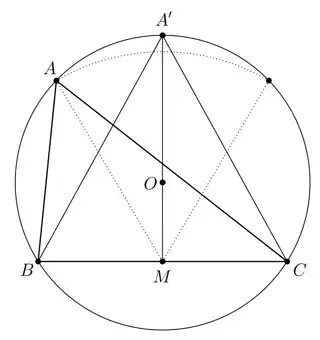

$$OH^2 = 9R^2-(a^2+b^2+c^2)\geq 0, $$ see this question. A self-contained explanation might proceed as follows: enter image description here
Assume that $A,B,C$ lie on some circle centered at $O$, with $B,C,O$ being fixed and $A$ being free to move on the (major, or minor) $BC$-arc. Let $M$ be the midpoint of $BC$. It is straightforward to notice that $AB^2+AC^2$ only depends on $AM^2$, hence it is maximized when $A$ lies on the perpendicular bisector of $BC$. It also follows that among the triangles with the same circumradius, the equilateral triangles (and they only) maximize the sum of the squared side lengths, so $a^2+b^2+c^2\leq 9R^2$.
