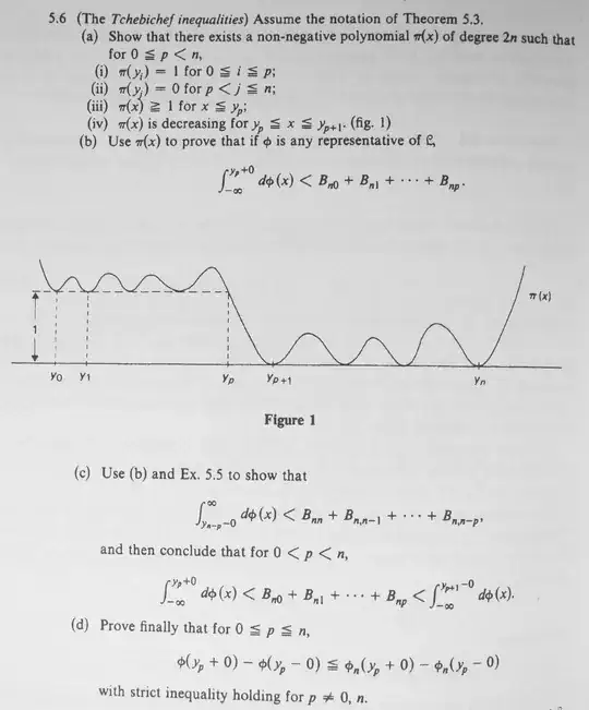

    Ah, I knew I've seen something similar, in an exercise in a book by Chihara. Yes, you're absolutely correct, and you've rediscovered the Chebyshev–Markov–Stieltjes inequalities. –  Jan 11 '18 at 14:39
  • @ProfessorVector probably means Exercise 5.6 in Chapter II of Chihara, An Introduction to Orthogonal Polynomials (1978). This is embedded in a 70-page account of positive-definite moment functionals, intervals of orthogonality, spectral points, quasi-orthogonal polynomials, kernel polynomials, and representation by Stieltjes integrals, using a few special notations. I have taken the liberty of extracting the [mostly!] simple algebraic argument from its elaborate context, and posting it as a self-contained answer. – Calum Gilhooley Sep 04 '18 at 23:02

This proof is based closely on Exercise 5.6 in Chapter II of Theodore S. Chihara, An Introduction to Orthogonal Polynomials (Gordon and Breach 1978, reprinted by Dover 2011).
Chihara (1978), Chapter II, Exercise 5.6
Given $n \geqslant 1$, and $i$ with $1 \leqslant i \leqslant n$, we prove below that there exists a polynomial $f$ such that:
  1. $f$ has degree $2n - 2$;
  2. $f(x) \geqslant 0$ for all $x$;
  3. $f(x) \geqslant 1$ for $x \leqslant x_i$;
  4. $f(x_1) = f(x_2) = \cdots = f(x_i) = 1$;
  5. $f(x_{i+1}) = f(x_{i+2}) = \cdots = f(x_n) = 0$;
  6. $f(x) \ne 0$ if $x \notin \{x_{i+1}, x_{i+2}, \ldots, x_n\}$.
The $n$-point Gaussian quadrature formula applied to a function $f$ holds as an exact identity when $f$ is a polynomial of degree $2n - 1$ or less, therefore: $$ 1 + x_i = \int_{-1}^{x_i}dx < \int_{-1}^1f(x)\,dx = \sum_{j=1}^n w_jf(x_j) = w_1 + w_2 + \cdots + w_i. $$ Applying this inequality to $n - i + 1$ in place of $i$, and using the symmetry of the abscissae and weights, and the fact that the sum of the weights is $2$, we get: \begin{align*} 1 + x_i & = 2 - (1 + x_{n-i+1}) \\ & = (w_1 + w_2 + \cdots + w_n) - (1 + x_{n-i+1}) \\ & > (w_1 + w_2 + \cdots + w_n) - (w_1 + w_2 + \cdots + w_{n-i+1}) \\ & = (w_1 + w_2 + \cdots + w_n) - (w_n + w_{n-1} + \cdots + w_i) \\ & = w_1 + w_2 + \cdots + w_{i-1}. \end{align*} Finally, then: $$ w_1 + w_2 + \cdots + w_{i-1} - 1 < x_i < w_1 + w_2 + \cdots + w_i - 1. $$ $\square$
It remains to prove that $f$ exists.
