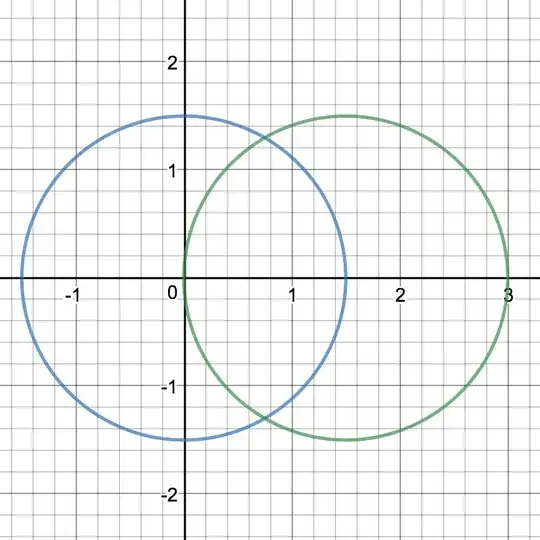

If the second curve has equation $r=2a\cos\theta$, it's a circle.
Intersection of circles The two circles intersect when $$ 2a \cos\theta = a \implies \cos\theta = \frac{1}{2} \implies \theta = \pm\frac{\pi}{3} $$ Therefore the area of the region is \begin{align*} \int_{-\pi/3}^{\pi/3} \int_a^{2 a\cos\theta} r\,dr\,d\theta &= 2 \int_{0}^{\pi/3} \int_a^{2 a\cos\theta} r\,dr\,d\theta \\ &= \int_{0}^{\pi/3}\left. r^2 \right|_a^{2 a\cos\theta} \,d\theta \\ &= \int_{0}^{\pi/3}\left(4a^2\cos^2\theta - a^2\right)\,d\theta \\ &= a^2 \int_{0}^{\pi/3}\left(2(1+\cos2\theta) - 1\right)\,d\theta \\ &= a^2 \int_{0}^{\pi/3}\left(1+2\cos2\theta\right)\,d\theta \\ &= a^2 \left[\theta+\sin 2\theta\right]_{0}^{\pi/3}\\ &= a^2 \left(\frac{\pi}{3} + \frac{\sqrt{3}}{2}\right) \end{align*}

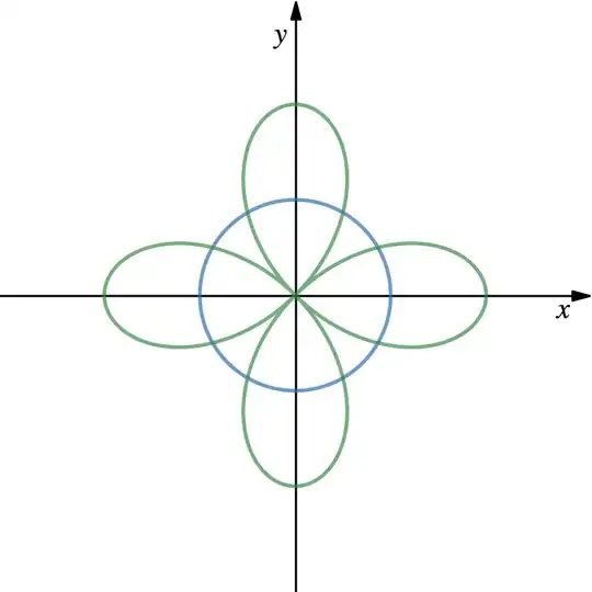

If the second curve has equation $r=2a\cos2\theta$, it's a rose of four leaves. intersection of rose and circle The curves intersect when $$ a = 2a \cos2 \theta \implies \cos2 \theta = \frac{1}{2} $$ The portion in the right half-plane has three components. Let's find the area of the largest component. That is the portion with $-\frac{\pi}{6} \leq \theta \leq \frac{\pi}{6}$. Its area is $$ A = 2 \int_0^{\pi/6}\int_0^{2a\cos2 \theta} r\,dr\,d\theta $$ Substituting $\phi = 2\theta$ and $d\phi = 2d\theta$ transforms this integral into the previous one. So $$ A = \frac{1}{2}\cdot a^2 \left(\frac{\pi}{3} + \frac{\sqrt{3}}{2}\right) = a^2 \left(\frac{\pi}{6} + \frac{\sqrt{3}}{4}\right) $$
  • In the first case diameter is $2a$, not $3a$ – Narasimham Jan 10 '18 at 15:53
  • In the first case of two intersecting circles I don't think the answer is right. I can't work out where you went wrong but https://math.stackexchange.com/a/402891/5011 shows the answer I get by a geometric approach (rather than using integrals). – Chris Jan 10 '18 at 16:06
  • @Narasimham: If you are talking about the graph then a = 1.5 in those graphs (I don't know why but it is). – Chris Jan 10 '18 at 16:07
  • Both circles need to be scaled down – Narasimham Jan 10 '18 at 16:16
  • @Chris Are we talking about the same region? The linked question seems to ask about the region which is inside both circles. As I read the OP's question it seems to ask about the region outside the center (blue) circle but inside the green circle. – Matthew Leingang Jan 10 '18 at 17:40
  • @Narasimham: I used a Desmos applet with a parameter $a$. For purposes of the diagram I set $a$ to be 1.5. If I get a chance I'll redo it, display the parameter, and provide a link. – Matthew Leingang Jan 10 '18 at 17:42
  • @MatthewLeingang: Ah yes, you may be right. My bad! I think I saw two intersecting circles and just assumed. :) – Chris Jan 10 '18 at 19:08
