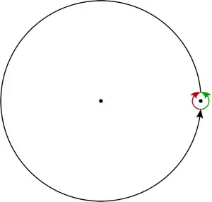

Another way to compute the Cauchy Principal Value is using Contour Integration.
To avoid the singularity, we can make a semicircular arc on either side of the singularity, as below in red and green.
$\hspace{4.5cm}$enter image description here
The residue of $\frac1{z(z-1)}=\frac1{z-1}-\frac1z$ at $z=0$ is $-1$ and the residue at $z=1$ is $+1$.
Since the green semicircle (of radius $\epsilon$) goes half-way counterclockwise around the singularity at $z=1$, the limit of the integral as $\epsilon\to0$ is only $\pi i$ times the residue, not $2\pi i$. That is, the integral over the green semicircle is $\pi i$.
Since the red semicircle (of radius $\epsilon$) goes half-way clockwise around the singularity at $z=1$, the limit of the integral as $\epsilon\to0$ is $-\pi i$ times the residue. That is, the integral over the red semicircle is $-\pi i$.
The contour consisting of the black circle and green arc contains both singularities, so the integral over that contour is $2\pi i$ times the sum of the residues, which is $0$. Taking out the integral over the green semicircle leaves that the integral over the black circle is $-\pi i$.
The contour consisting of the black circle and red arc contains only the singularity at $z=0$, so the integral over that contour is $2\pi i$ times this residue, which is $-2\pi i$. Taking out the integral over the red semicircle leaves that the integral over the black circle is $-\pi i$.
Thus, both contours give that the integral over the black circle is $-\pi i$. This is the same as the Cauchy Principal Value since we took out equal parts of the contour on either side of $z=1$.
