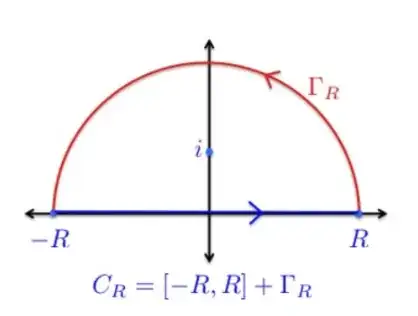

For the second one, function $\frac{\cos{x}}{1+x^6}$ is even, as a result $$\int\limits_{0}^{\infty}\frac{\cos{x}}{1+x^6}dx= \lim\limits_{R\rightarrow\infty} \int\limits_{0}^{R}\frac{\cos{x}}{1+x^6}dx=\frac{1}{2} \lim\limits_{R\rightarrow\infty} \int\limits_{-R}^{R}\frac{\cos{x}}{1+x^6}dx=...$$
Now $\frac{\sin{x}}{1+x^6}$ is odd and as a result $\int\limits_{-R}^{R}\frac{\sin{x}}{1+x^6}dx=0$, thus $$...=\frac{1}{2} \lim\limits_{R\rightarrow\infty} \int\limits_{-R}^{R}\frac{\cos{x}+i\sin{x}}{1+x^6}dx=\frac{1}{2} \lim\limits_{R\rightarrow\infty} \int\limits_{-R}^{R}\frac{e^{ix}}{1+x^6}dx=...$$ Now we will look at this contour
$$...=\frac{1}{2} \lim\limits_{R\rightarrow\infty} \left(\int\limits_{C_R}\frac{e^{iz}}{1+z^6}dz - \int\limits_{\Gamma_R}\frac{e^{iz}}{1+z^6}dz \right)=\\ \frac{1}{2} \lim\limits_{R\rightarrow\infty} \left(\int\limits_{C_R}\frac{e^{iz}}{(z-i)(z+i)\left(z-\frac{\sqrt{3}}{2}-\frac{i}{2}\right)\left(z+\frac{\sqrt{3}}{2}+\frac{i}{2}\right)\left(z-\frac{\sqrt{3}}{2}+\frac{i}{2}\right)\left(z+\frac{\sqrt{3}}{2}-\frac{i}{2}\right)}dz \\ - \int\limits_{\Gamma_R}\frac{e^{iz}}{1+z^6}dz \right)= \frac{1}{2} \lim\limits_{R\rightarrow\infty} \left(\text{Res}\left(\frac{e^{iz}}{1+z^6},i\right)+ \text{Res}\left(\frac{e^{iz}}{1+z^6},\frac{\sqrt{3}}{2}+\frac{i}{2}\right)+\\ \text{Res}\left(\frac{e^{iz}}{1+z^6},-\frac{\sqrt{3}}{2}+\frac{i}{2}\right) - \int\limits_{\Gamma_R}\frac{e^{iz}}{1+z^6}dz \right)=\\ \frac{1}{2}\left(\text{Res}\left(\frac{e^{iz}}{1+z^6},i\right)+ \text{Res}\left(\frac{e^{iz}}{1+z^6},\frac{\sqrt{3}}{2}+\frac{i}{2}\right)+ \text{Res}\left(\frac{e^{iz}}{1+z^6},-\frac{\sqrt{3}}{2}+\frac{i}{2}\right)\right)$$ It remains to show that $$\lim\limits_{R\rightarrow\infty} \int\limits_{\Gamma_R}\frac{e^{iz}}{1+z^6}dz =0$$ which is $$\left|\int\limits_{\Gamma_R}\frac{e^{iz}}{1+z^6}dz\right| \leq \text{length}(\Gamma_R) \max\limits_{z \in \Gamma_R}\left|\frac{e^{iz}}{1+z^6}\right|=\pi R \max\limits_{z \in \Gamma_R}\frac{|e^{iz}|}{\left|1+z^6\right|}\leq \pi R \max\limits_{z \in \Gamma_R}\frac{|e^{i(x+iy)}|}{\left||z^6|-|1|\right|}\leq\\ \pi R \frac{e^{-y}}{\left|R^6-1\right|}\leq \frac{\pi R}{R^6-1} \rightarrow 0, R \rightarrow \infty$$
