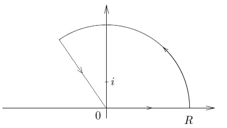

Following Daniel Fischer's advice, namely to use a circular sector of angle $2\pi/3$ with radius $R>1$. The contour is shown below.
Before getting to work, the Logarithm that will be used is the Principal Logarithm. Okay, we integrate the following: \begin{align} \oint_C\frac{z^\alpha}{1+z^3}\,dz \end{align} The only pole inclosed is $z=e^{i\pi/3}$ so we get by the Residue Theorem: \begin{align} \oint_C\frac{z^\alpha}{1+z^3}\,dz&=2\pi i \operatorname{Res}_{z=e^{i\pi/3}}\frac{z^\alpha}{1+z^3}\\ &=2\pi i \frac{e^{i\pi/3}e^{i\alpha\pi/3}}{(e^{i2\pi/3}-e^{-i2\pi/3})(e^{i\pi/3}-e^{-i\pi/3})}\\ &=-i\pi \frac{e^{i\pi/3}e^{i\alpha\pi/3}}{2\sin(\pi/3)\sin(2\pi/3)} \\ &=-i\frac{2\pi}{3}e^{i\pi/3}e^{i\alpha\pi/3} \end{align} Moreover we have: \begin{align} \tag{1} \oint_C\frac{z^\alpha}{1+z^3}\,dz = (1-e^{i\alpha2\pi/3}e^{i2\pi/3})\int^R_0 \frac{t^\alpha}{t^3+1}\,dt + \int_{B_R}\frac{z^\alpha}{1+z^3}\,dz \end{align} The last one is the integral on the circular part and that goes to zero as $R\to\infty$ hence: \begin{align} (1-e^{i\alpha2\pi/3}e^{i2\pi/3})\int^\infty_0 \frac{t^\alpha}{t^3+1}\,dt=-i\frac{2\pi}{3}e^{i\pi/3}e^{i\alpha\pi/3} \end{align} Hence: \begin{align} \int^\infty_0 \frac{t^\alpha}{t^3+1}\,dt&=-i\frac{2\pi}{3}\frac{e^{i\pi/3}e^{i\alpha\pi/3}}{1-e^{i\alpha2\pi/3}e^{i2\pi/3}}\\ \end{align} Simplifying the last expression:
$$\int^\infty_0 \frac{t^\alpha}{t^3+1}\,dt=\frac{\pi}{3\sin[(1+\alpha)\pi/3]}$$
