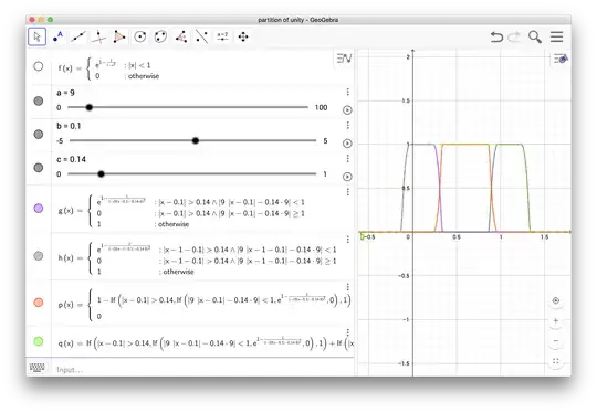

Thrown together in Geogebra. You don't want to touch the b slider, sorry. Parameter a is how steep the bump function needs to be, so that the stuff happening in $U_1$ doesn't interact with the stuff in $U_3$. Parameter c is the size of $U_1\setminus \overline{U_2}$ which I took to also be the size of $U_3\setminus \overline{U_2}$. Allow me to leave what exactly $U_i$ are in this picture as an exercise...
g is your usual bump function that is 1 inside $U_1 \setminus \overline{U_2}$ and quickly drops off to 0 by the time it hits $\partial U_1$.
h is similarly made (actually I was lazy and translated a copy of g). Once $f_1=$g and $f_3=$h were created, $f_2=$p$=1-g-h$ is easy.
The dashed green line verifies that their sum is 1.
I've done nothing more than roughly follow the construction as laid out in text books, e.g. Lee's Manifolds.
