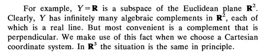

Functional Analysis: Kreyszig, Page 146
It said that $\mathbb{R}$ a subspace of the Euclidean Plane $\mathbb{R}^2$. But $\mathbb{R}$ is not even a subset of $\mathbb{R}^2$. How can it be possible? Thank you for helping.

    They are not being literal. It is isomorphic to a subspace of the plane.Such as {(x,0) | x is real } with the inherited topology. – Jacob Wakem Dec 27 '17 at 18:27

    Authors shouldn't do this, without explanation, the first time it is done. – zhw. Dec 27 '17 at 19:24

  • I was curious, so I looked through my copy of Kreyszig's book just now (I took a course in 1984 that used Kreyszig's book) to see if there is any prior mention in the book of an "abuse of terminology" convention for a case such as this, and I couldn't find one. So it appears this is an editing oversight. – Dave L. Renfro Dec 27 '17 at 20:47
  • This is a functional analysis book, not linear algebra. It's an easy omission to forgive as far as I'm concerned, especially since the preface indicates the reader is expected to have an undergrad linear algebra background. @MichaelHardy, I don't understand why a good answer has to be long and messy. Is there a reason writing down the function $\Phi : x \mapsto x e_{1} + 0 e_{2}$ and proving it's an injective linear map wouldn't suffice? –  Dec 27 '17 at 20:54

  • It's probably worth mentioning that Kreyszig's book is fairly elementary, and he even develops all the basic concepts from linear algebra that are needed, so given the context and the level of his book at page 146, the $x$-axis should have been used, or perhaps better, word it as he did but include a footnote along the lines of "Of course, by $\mathbb R$ we mean [. . .]". – Dave L. Renfro Dec 27 '17 at 21:25

Identify $R$ with $R \times \{0\}$, the Cartesian product of $R$ and $\{0\}$ by the isomorphism $f(x)=(x,0)$.
That is what they mean when they talk about the real line being a subspace of the Cartesian plane.
I take as my definition of the vector space $(\mathbb{R}^{2},+,\cdot)$ the set $\mathbb{R}^{2} = \{(x,y) \, \mid \, x, y \in \mathbb{R}\}$ with the operations $(x,y) + (z,w) = (x + z, y + w)$ and $\lambda \cdot (x,y) = (\lambda x, \lambda y)$ with the addition and multiplication of the coordinates inherited from the corresponding operations in the complete ordered field $\mathbb{R}$. I will prove that $\mathbb{R}$ is isomorphic to a linear subspace of $\mathbb{R}^{2}$. In particular, I will prove that $\mathbb{R} \simeq \{(x,0) \mid x \in \mathbb{R}\}$.
Define a linear map $\Phi : \mathbb{R} \to \mathbb{R}^{2}$ by $$\Phi(x) = (x,0).$$ This is linear since \begin{align*} \Phi(x + y) &= (x + y, 0) = (x,0) + (y,0) = \Phi(x) + \Phi(y) \\ \Phi(\lambda x) &= (\lambda x, 0) = (\lambda x, \lambda \cdot 0) = \lambda (x,0) = \lambda \Phi(x). \end{align*} Moreover, $\Phi$ is injective. Indeed, if $\Phi(x) = \Phi(y)$, then \begin{align*} \Phi(x) = (x,0) = (y,0) = \Phi(y) \end{align*} which implies $x = y$ by the definition of (the set) $\mathbb{R}^{2}$. Thus, $\Phi$ is injective. Recall that the image of a linear map is always a linear subspace of the target. In particular, $\Phi(\mathbb{R})$ is a linear subspace of $\mathbb{R}^{2}$. Since $\Phi$ is injective, $\Phi : \mathbb{R} \to \Phi(\mathbb{R})$ is a bijective linear map. It is immediate that $\Phi(\mathbb{R}) = \{(x,0) \, \mid \, x \in \mathbb{R}\}$. This completes the proof that $\mathbb{R} \simeq \{(x,0) \, \mid \, x \in \mathbb{R}\}$.
If you've read this far, I hope you will try to "draw" the line $\{(x,0) \, \mid \, x \in \mathbb{R}\}$ in the plane $\mathbb{R}^{2}$ (e.g. using Cartesian coordinates). A picture is worth a thousand words.

  • I am sorry that I am stupid, I still can not see that $\mathbb{R}$ is a subspace of $\mathbb{R}^2$ from your explanation. So you mean that $\mathbb{R}$ is a subspace of $\mathbb{R}^2$ is correct? Could you prove it by definition? – MH Yip Dec 27 '17 at 23:29
  • You are not stupid, mathematicians are lazy. $\mathbb{R}$ is not a subset of $\mathbb{R}^{2}$ so the statement "$\mathbb{R}$ is a subspace of $\mathbb{R}^{2}$" is technically wrong. You are right to question it. The intention of the statement is "$\mathbb{R}$ is isomorphic to a linear subspace of $\mathbb{R}^{2}$ in a natural way, for example, by sending $x$ to the point $(x,0)$." $\mathbb{R}$ is not a subspace of $\mathbb{R}^{2}$; it is isomorphic to one in a very clear geometric fashion. –  Dec 27 '17 at 23:34
  • But, in fact $\mathbb R$ is not a subspace of $\mathbb R^2$. So you answered you can extend $\mathbb R$ to create a space isomorphic to $\mathbb R$. But you fail to emphasize that in fact $\mathbb R$ is not in fact a subspace of $\mathbb R^2$; only the extension of $\mathbb R$ to $ \mathbb R^2$ is a proper subspace of $\mathbb R^2$. Hence, you fail to answer correctly that in fact $\mathbb R$ is not, in itself, without the constructed extension, a subspace of $\mathbb R^2$. – amWhy Sep 05 '18 at 15:28
Technically you are right and as was stated in the comments, maybe authors should not do this without explanation.
Consider the $\mathbb R^2 = $ the $x$-$y$ plane $= $ "the $x$-axis crossed with the $y$-axis" = $\{(x,y)\mid x\in \mathbb R, y\in \mathbb R\}$ or any other way we will introduce this concept to students for the first time.
Now, consider immediately introducing $\mathbb R^3 = $ the $x-y-z$ space $= $ "the $x$-axis crossed with the $y$-axis crossed with the $z$-axis" = $\{(x,y,z)\mid x,y,z\in \mathbb R\}$
Now suppose some well-meaning instructor or some bright elementary student claimed that "the" $x-y$ plane and "the" $x$-axis and $y$-axis we refered to in defining the 2-D plane were the "same" $x$-axis and $y$-axis as in 3D space but with $z$ being restricted to $0$.
Would the instructor/student be right or wrong? Or would it be a case of "It depends on how you look at it".
Basically the author is viewing $\mathbb R \subset \mathbb R^2 \subset \mathbb R^3 \subset \cdots$ via $\mathbb R^n = \mathbb R^n \times \{0\} \subset \mathbb R^n \times \mathbb R = \mathbb R^{n+1}$. In other words, as thought there is one universal abstract set of axes, and $\mathbb R^n$ and $\mathbb R^{n+1}$ have the same axes but $\mathbb R^n$ is restricted to $x_{n+1} = 0$.
Is this legitimate? Is this fair?
Well, sort of. But.... not really.
It's "clear" that $\mathbb R^n \times \{0\} = \{(x_1, x_2, \ldots , x_n, 0)\in R^{n+1}\}$ is isomorphic and in every possible sense equivalent. And it "doesn't matter" that $\mathbb R^n \times \{0\}$ are not the same thing; in every important sense they might as well be.
But then on the other hand they are clear not the same thing at all.
