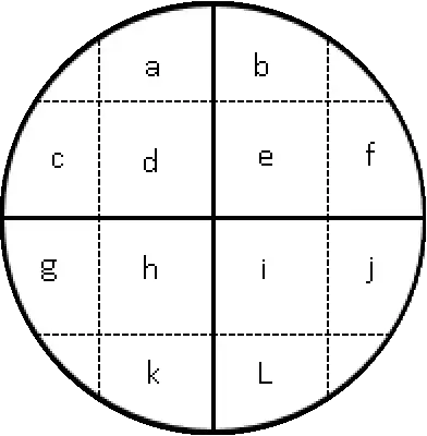

WORK PREVIOUS I've recently been stumped on a simple pizza cutting problem that was brought to me by one of my friends at work.
Cut a pizza into 16 pieces where 12 of the pieces have equal area. More specifically A=B=C=D=E=F=G=H=I=J=K=L in enter image description here Find where the pizza should be cut to satisfy this problem.
My first step was to make a visualization of the pizza in Desmos. From this visualization (and later in algebra) you can see that the size of the pizza doesn't matter, and the length of the inner square $w$ remains constant in relation to r.
My next step was to isolate a symmetric quarter of the pizza enter image description here and find a relation between the known formulas. The area shaded in blue at the bottom was the key to me finding the formula that I need to be solved.

You are correct, the problem boils down to finding the $z\in(0,1)$ such that $$\int_{0}^{z}\sqrt{1-x^2}\,dx = 2z^2, $$ i.e. to solving $$ z\sqrt{1-z^2}+\arcsin(z)=4z^2 \tag{A}$$ or, by setting $z=\sin\theta$ and $\varphi=2\theta$, $$ 4\cos\varphi+\sin\varphi=4-\varphi. $$ Solving $(A)$ is essentially equivalent to solving Kepler's equation (see also this recent answer).
An approximate solution can be derived from the Shafer-Fink approximation $$\arcsin(x)\approx\frac{3x}{2+\sqrt{1-x^2}}\tag{B} $$ leading to $z\approx 0.48$. Such initial approximation can be refined through Newton's method, till reaching $z\approx 0.480068840868$, but there is no hope of getting a nice closed form for the solution of the trascendental equation appearing in (A).
