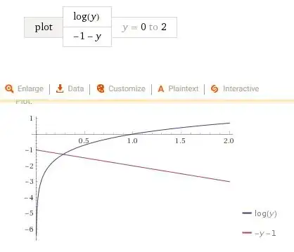

Solution for the first version: $ 1 -x + \ln -x=0 $
Let $y=-x$
$$ 1 -x + \ln -x=0 \implies 1 +y + \ln y =0 \implies \ln y=-1-y$$
that has exactly one solution
$$y ≈ 0.278464542761074...$$
which you can find by numerical method
