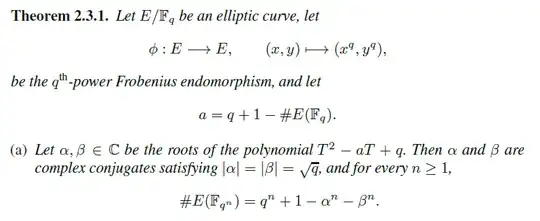

A couple of remarks. Firstly, a way of finding such $\alpha$ and $\beta$ pairs show's up in Silverman's book "The Arithmetic of Elliptic Curves." In particular:
