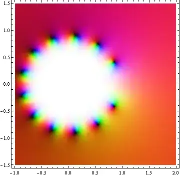

The series is convergent for $|x|>1$. Here is a plot of the function, in the complex plane:
Plot of f(x)
Red means near $1$, yellow-green is near $i$, blue is near $-i$, white is near $\infty$, black is near $0$. And here is a plot of the above asymptotic expansion, up to the $x^{-12}$ term:
Plot of asymptotic expansion
