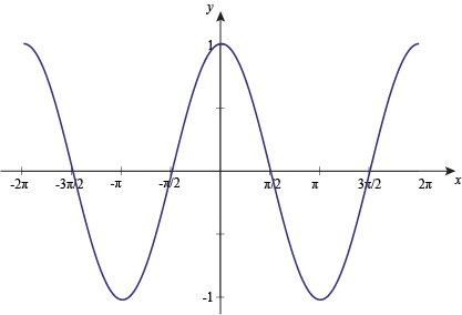

The function $f(x) = \cos(x)$ , $f : \mathbb R \to \mathbb R$ is not a linear function, so that assumption that you made will not hold. Note that the value $0.7071$ is not far away from $0.5$ because of the curved line that the $\cos$ function follows on the cartesian coordinate system, which isn't widely deviated from the line $y=x$. This does not mean that other non-linear functions will have "middle-point" values close to $0.5$ (that entirely depends on their polynomial approximation).
Check a simple graph down below :
Also checking the series representation of the cosine $\cos$ function, one can see that is clear that :
$$\cos(x) = \sum_{n=0}^\infty \frac{(-1)^n x^{2n}}{(2n)!}$$
has non-linear terms.

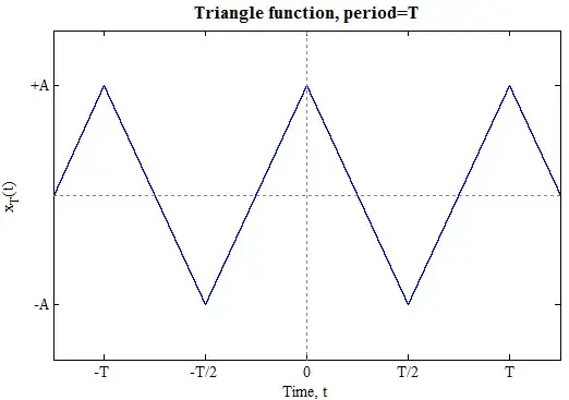

That kind of linear intrapolation requires that you are dealing with a linear function, but you're not. That is, your reasoning would work if the function looked like a triangular see-saw:
But the cosine function doesn't look like that ... see Rebellos' post! (we make a good team!)

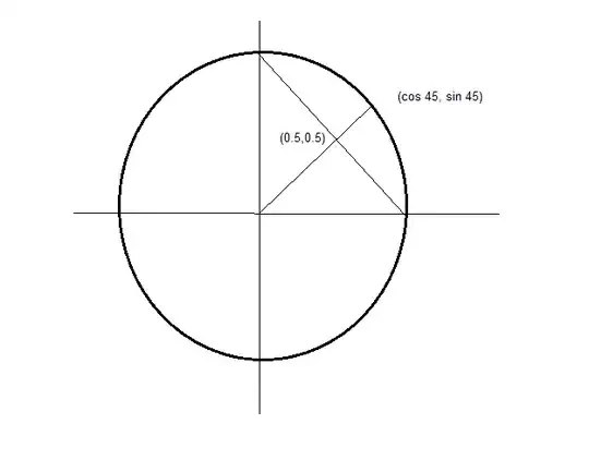

Take a look to the trigonometric circle, for an angle of 45 degrees $cos\theta$ is the side of a square with diagonal with length equal to 1 thus it’s equal to $\frac{\sqrt{2}}{2}$.
To better visualize take a look to the following figure:

It should be clear from this picture that $\cos 45^\circ > 0.5$
