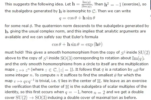

What I don't understand is what is written next about looking at two copies of $S^1$:
What is the copy of $S^1$ inside $\SU(2)$? What is the copy of $S^1$ inside $\SO(3)$? Is this related to the great circle in the unit sphere in $\mathbb{R}^3$ orthogonal to the element $h$? How is a smooth homomorphism $S^1 \rightarrow S^1$ given? And why is $\textrm{Ad}(q)$ then a rotation by $n \theta$ for some $n$?

    The rest of the sentence says "...corresponding to rotation about $\text{Im}(q)$." About any axis you can consider the one-parameter subgroup of $SO(3)$ or $SU(2)$ which corresponds to rotations about that axis; those are the copies of $S^1$ I mean. – Qiaochu Yuan Dec 15 '17 at 01:17
  • That makes sense for a homomorphism of $\mathbb{R}$ into $SO(3)$, with kernel $\mathbb{Z}$, you send $x$ to the rotation in the plane orthogonal to $\textrm{Im}(q)$ by $2 \pi x$ radians. I don't understand how the same reasoning can be applied to finding a homomorphism of $\mathbb{R}$ into $\SU(2)$. – D_S Dec 16 '17 at 22:07
  • The copy of $S^1$ inside $SU(2)$ being referred to is $\theta \mapsto \exp (h \theta)$. This has period $2 \pi$ because $h^2 = -1$. – Qiaochu Yuan Dec 18 '17 at 01:24
Qiaochu is correct in his responses. I read the blog post as well, it was well written.
When we select our $q$ from $SU(2)$, or rather our norm-1 quaternion, we are then given $h$, our axis of rotation. Following the blog we arrive at \begin{equation} q = \cos(\theta) + \bf{h}\sin(\theta) = e^{\bf{h}\theta} \end{equation} for some real $\theta$. The copy of $S^1$ in $SU(2)$ is the copy of $S^1$ in $SU(2)$ as a "subspace" of $\mathbb{H}$, explicitly we have elements \begin{equation} \eta(\phi) \equiv \cos(\phi) + \bf{h}\sin(\phi)\end{equation} which are all norm-1 quaternions. The exponential formula gives that this is a homomorphism in $\phi$ mapping $S^1$ to the $SO(3)$ subgroup of rotations about $\bf{h}$, which we identify as another copy of $S^1$.
About the rotation. So we know that $\mathop{Ad}q$ is a rotation about $\bf{h}$ of some angle, in fact $\eta(\phi)$ are all rotations of varying angles. From above though we see that if $\phi = 0, \pi$, then $\eta(\phi) = \pm1$ which make trivial adjoint actions, and thus must be $\mathbb1 \in SO(3)$. Since only elements of the real subspace of $\mathbb H$ will have trivial adjoint actions, these two choices of $\phi$ are the only ones, meaning as $\phi$ runs from $0$ to $\pi$, the rotations must run through $2\pi$. So then the mapping $\eta(\phi)$ is $2\to1$ from $S^1 \subset SU(2)$ to the rotations $S0(3)$. Explicitly, a quaternion $q = \cos\theta + \bf{h_q}\sin\theta$ is the rotation about $\bf{h_q}$ of $2\theta$.
