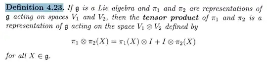

Method A: What Wikipedia suggests here is taking the tensor product of 2 known representations of $sl(2,C)$ to obtain a new representation of the complex Lie algebra $sl(2,C)$. This seems to be based on a definition Brian C. Hall also stated in his book.enter image description here
Note I already have the irreducible representations of $su_C(2)$, which means I already have representations of the complex lie algebra $sl(2,C)$. Method A doesn't give me representations of $sl(2,C)_R$ nor $sl_C(2,C)$ (which is what I want), instead only gives me more representations of just $sl(2,C)$. If applying Defintion 4.23 would give me at least the rep. of $sl_C(2,C)$ I could see why is A helpful.
Question 1) Why is A necessary to obtain rep of $sl(2,C)_R$?
