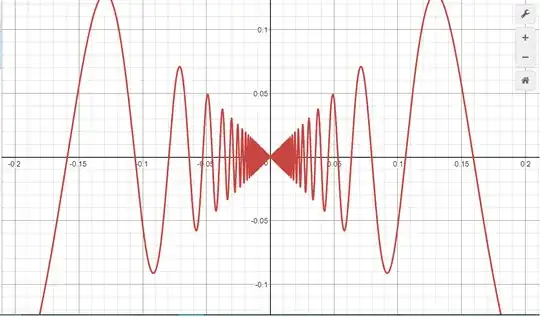

Determine whether the set is closed or open ,both, or neither $$\left \{ (x,y)\in \mathbb{R}^2:y=x\sin \frac{1}{x},x\in\mathbb{R} \right \}$$
my idea:
since set of derived points is equal to given set hence the set is closed
is I am right what bout open..is this set is open?

Note that $x\sin\frac1x$ is a continuous function for $x\in(-\infty,0)\cup(0,\infty)$. If $x\ne0$, then for any sequence $x_n$ converging to $x$, $(x_n,x_n\sin\frac1{x_n})$ converges to $(x,x\sin\frac1x)$. We just need to compute the limits of this function for $x\rightarrow0$. Show that $\lim_{x\rightarrow0}x\sin\frac1x=0$. This $(0,0)$ is a limit point of this set. But $(0,0)$ doesn't lie in this set. Thus the set contains all its limit points except $(0,0)$.
QED

  • See that $y=x\sin\frac1x$ is undefined at $x=0$. So no point of the form $(0,a)$ can be in the set – QED Dec 11 '17 at 14:14
Set is not open. Please see the figure. Apply the definition of open set enter image description here
