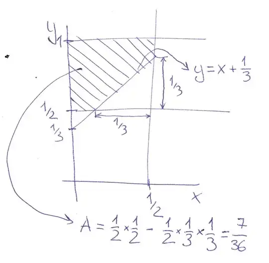

Since you are integrating a constant function, it's going to be so much easier if you draw yourself a picture of the area and use simple geometry, rather than integrating an analytic expression:
And dividing the hatched area by the total square area, the resulting probability is $\frac{7}{36}/\frac{1}{4} = \frac{7}{9}$
