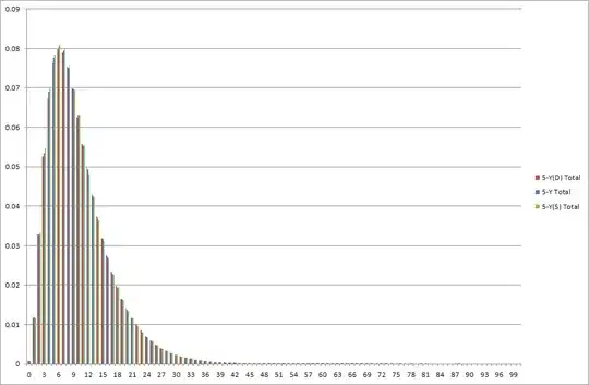

For interest, here are the results of the 5-Yahtzee using 3 slightly different algorithms. The D (for dumb) algorithm sets the point at the highest mode on the first roll (i.e. it will match a single die), the normal algorithm sets the point on the first pair or better, the S (for smart) sets the point on the first pair or better but will switch if 3 of a kind come up on the other 3 dice.
5-Yahtzee
The means of the three algorithms are 10.24, 10.16 and 10.10 respectively.
