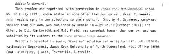

This problem was proposed by Kenneth S. Williams, Carleton University, Ottawa in CRUX 247[1977;131] and in CRUX[1978;23,37] it is said enter image description here that there is a nice simple proof but I can't find this G. Szekeres (October 1977 was published by Rennie in JCMN, NO.12) shorter proof. Can help me? Thanks.
Maybe now this inequality have some methods to solve it, such as AM-GM inequality?
