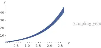

The solution set for this equation is:
But again i don't think i can fully understand this.
