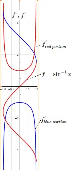

It is the very definition of derivative of the given sine inverse function:
$$ \lim_{x \to x_0}{\frac{\arcsin x-\arcsin x_0}{x-x_0}} $$
$$ = \frac{d(arcsin x)}{dx}= \frac{1}{\sqrt {1-x^2}}$$
$$ =\frac{\pm 1}{\sqrt {1-x_0^2}},\,$$
EDIT1:
evaluated at $x=x_0.$ Double sign is applicable, sign is taken positive if in red portion, negative for blue portion of $f(x)$ and infinite slope at $x=\pm 1$ As inverse trig function is periodic and unbounded, only some portions are shown. Apologies, the bottom most arcsin function $(f< \pi/2)$ is incorrectly colored red, should be blue.
Narasimham
