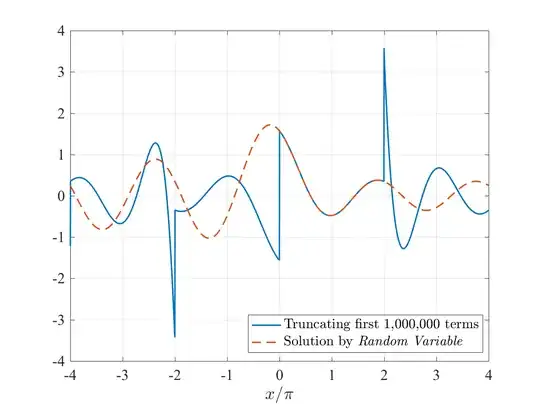

Edit #2: I tested the solution solved by Random Variable (see the most ranked answer and thousands thanks to it!) compared with the truncating results:
$$ \sum_{n=1}^N\frac{\sin \left(x\sqrt{n^2+a^2}\right)}{\sqrt{n^2+a^2}}, N = 1,000,000, a=1 $$
Here is the solution by @Random Variable: the solution of equation (2) as the following:
$$ \sum_{n={1}}^\infty \frac{\sin\left(x\sqrt{n^2+a^2}\right)}{\sqrt{n^2+a^2}} = \frac{\pi}{2} J_0(ax) -\frac{\sin(ax)}{2a}, a>0, 0<x<2\pi\qquad(2*) $$ where $J_0(ax)$ is the Bessel function of the first kind of order zero.
Here is the comparison: enter image description here
It can be found that the both agree well when $0 <x<2\pi$,but differ in other domain. So, how about the solution beyond $(0,2\pi)$?

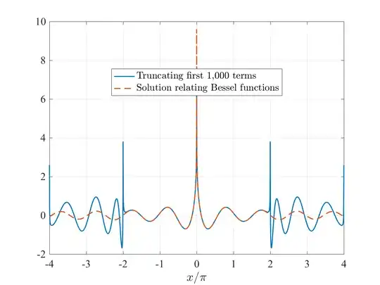

Inspired by Random Variable's answer, I found the solution of equation (3) as the following:
$$ \sum_{n={1}}^\infty \frac{\cos\left(x\sqrt{n^2+a^2}\right)}{\sqrt{n^2+a^2}} = -\frac{\pi}{2} Y_0(ax) -\frac{\cos(ax)}{2a}, a>0, 0<x<2\pi\qquad(3*) $$ where $Y_0(ax)$ is the Bessel function of the second kind of order zero.
Here is the comparison: enter image description here Note that equation (3) is divergent when $x=0$.

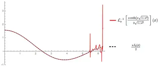

COMMENT to users: Achille-Hui and Random-Variable
How about this ?:
$$\sum _{n=0}^{\infty } \frac{\sin \left(x \sqrt{n^2+a^2}\right)}{\sqrt{n^2+a^2}}=\frac{1}{2} \pi J_0(a x)+\frac{\sin (a x)}{2 a}$$
$$\sum _{n=0}^{\infty } \mathcal{L}_x\left[\frac{\sin \left(x \sqrt{n^2+a^2}\right)}{\sqrt{n^2+a^2}}\right](s)=\frac{1}{2} \pi J_0(a x)+\frac{\sin (a x)}{2 a}$$
$$\mathcal{L}_s^{-1}\left[\sum _{n=0}^{\infty } \frac{1}{a^2+n^2+s^2}\right](x)=\frac{1}{2} \pi J_0(a x)+\frac{\sin (a x)}{2 a}$$
$$\mathcal{L}_s^{-1}\left[\frac{1}{2 \left(a^2+s^2\right)}+\frac{\pi \sqrt{-a^2-s^2} \cot \left(\pi \sqrt{-a^2-s^2}\right)}{2 \left(a^2+s^2\right)}\right](x)=\frac{1}{2} \pi J_0(a x)+\frac{\sin (a x)}{2 a}$$
$$\mathcal{L}_s^{-1}\left[\frac{1}{2 \left(a^2+s^2\right)}\right](x)+\mathcal{L}_s^{-1}\left[-\frac{\pi \cot \left(\pi \sqrt{-a^2-s^2}\right)}{2 \sqrt{-a^2-s^2}}\right](x)=\frac{1}{2} \pi J_0(a x)+\frac{\sin (a x)}{2 a}$$
for $a>0$ and $s>0$
$$\frac{\sin (a x)}{2 a}+\mathcal{L}_s^{-1}\left[\frac{\pi \coth \left(\pi \sqrt{a^2+s^2}\right)}{2 \sqrt{a^2+s^2}}\right](x)=\frac{1}{2} \pi J_0(a x)+\frac{\sin (a x)}{2 a}$$ $$\mathcal{L}_s^{-1}\left[\frac{\pi \coth \left(\pi \sqrt{a^2+s^2}\right)}{2 \sqrt{a^2+s^2}}\right](x)=\frac{1}{2} \pi J_0(a x)$$
$$\mathcal{L}_x\left[\mathcal{L}_s^{-1}\left[\frac{\pi \coth \left(\pi \sqrt{a^2+s^2}\right)}{2 \sqrt{a^2+s^2}}\right](x)\right](s)=\mathcal{L}_x\left[\frac{1}{2} \pi J_0(a x)\right](s)$$
$$\frac{\pi \coth \left(\pi \sqrt{a^2+s^2}\right)}{2 \sqrt{a^2+s^2}}\neq \frac{\pi }{2 \sqrt{a^2+s^2}}$$
and then:
$$\sum _{n=0}^{\infty } \frac{\sin \left(x \sqrt{n^2+a^2}\right)}{\sqrt{n^2+a^2}}\neq \frac{1}{2} \pi J_0(a x)+\frac{\sin (a x)}{2 a}$$
EDITED:
Comparison a numeric InverseLaplaceTransform and Bessel function:
  • OP's simulation already tell us $f_a(x) \ne \frac12\pi J_0(ax) + \frac{\sin(ax)}{2a}$ outside the interval $(0,2\pi)$. If you want to show this also fails for $x \in (0,2\pi)$, what you have done is not enough, you need to compute the Laplace transform with functions clipped within $(0,2\pi)$. – achille hui Nov 29 '17 at 18:43
