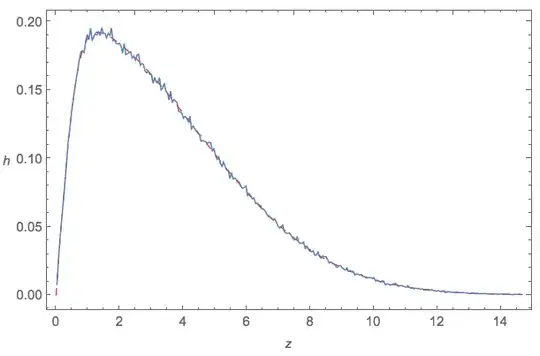

If $X \sim N(0,\sigma^2)$ and $Y \sim N(0,s^2)$, then given independence, the pdf of $Z = |X| + |Y|$ is given by the current developmental build of mathStatica as say $h(z)$:
$$h(z) = \frac{1}{\sqrt{s^2+\sigma ^2}} \sqrt{\frac{2}{\pi }} \exp \left( -\frac{z^2}{2 \left(s^2+\sigma ^2\right)} \right) \left(\text{erf}\left(\frac{\sigma z}{\sqrt{2} s \sqrt{s^2+\sigma ^2}}\right)+\text{erf}\left(\frac{s z}{\sqrt{2} \sigma \sqrt{s^2+\sigma ^2}}\right)\right)$$
This is just a one-liner to evaluate, and may be helpful to verify your manually derived solution $f(z)$.
The following is a quick Monte Carlo check of the theoretical solution above when $\sigma = \frac12$ and $s = 4$.
Looks fine. That just leaves integrating the pdf :)
