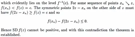

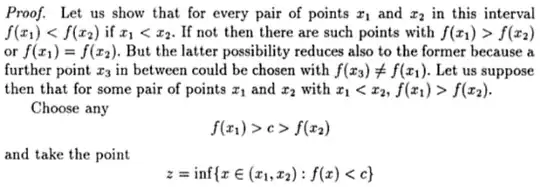

Here is the proof of the theorem in Thomson's book:
