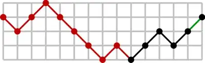

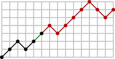

Let's start with a path of length $2n$ that ends up where it started. If the last step is up (as shown in green), isolate the part of the path ending at the last point where it attains its minimum (shown in red). If the last step is down, isolate the part of the path ending at the last point where it attains its maximum.
Reverse that part of the path and move it to the end.
This matches paths of length $2n$ that never return to their starting point with paths of length $2n$ that end up at their starting point via a bijection. Thus, the number of paths of length $2n$ that never return to their starting point is $\binom{2n}{n}$.
