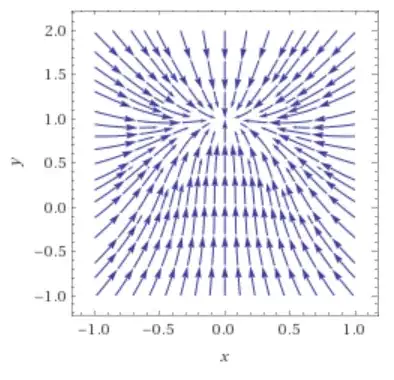

Qualitative analysis. To get a first insight of the solution, one can linearize the system in the vicinity of its equilibrium positions (cf. Hartman-Grobman theorem). If the time-evolution is set to zero, then one has $v_x = 0$ and $v_y = \sqrt{g/k}$. The Jacobian matrix $J_f$ of the mapping $\frac{\text{d}}{\text{d} t}(v_x,v_y) = f(v_x,v_y)$ is $$ J_f = -\frac{k}{\sqrt{{v_x}^2 + {v_y}^2}} \left( \begin{array}{cc} 2{v_x}^2 + {v_y}^2 & {v_x}v_y \\ {v_x}v_y & {v_x}^2 + 2{v_y}^2 \end{array} \right) . $$ Therefore, if $k>0$, the equilibrium position $(0,\sqrt{g/k})$ is stable, and the solution will be attracted by the equilibrium position. This can be viewed on the following phase diagram, where $k=g=1$:
Stream plot
