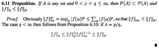

The following proposition and its proof are from Folland's Real Analysis:
Here the little $l^p$ means the $L^p$ space with the counting measure.
Here is my question:
How does one establish the equality $\|f\|_\infty^p=\sup_\alpha|f(\alpha)|^p$ when $A$ is not finite or uncountable? I believe this should have something to do with some property of the counting measure but I don't see how.
