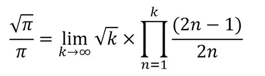

maybe it will help you. the answer in the image is a partial result
Since the root of k is necessary for it to converge to a value, I must assume that the limit of the production tends to zero, and that its rate of growth is equal to that of the square root of k
