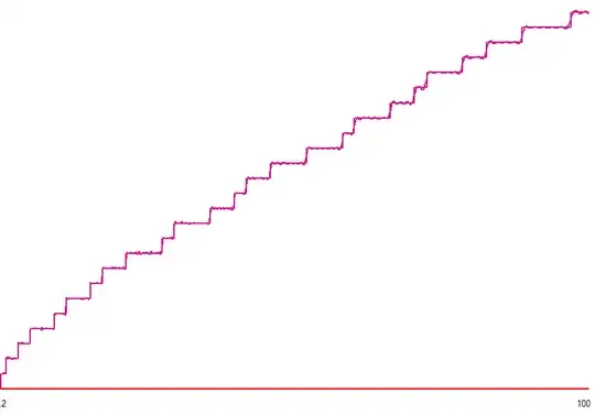

The result for $\;\pi(x),\;x\in(2,100)$ (starting with $R(x)$ evaluated using the Gram series, subtracting the exact $\;\displaystyle\frac 1{\log(x)}-\frac 1{\pi}\arctan\left(\frac{\pi}{\log(x)}\right)\;$ contribution for the trivial zeros and two times the real part of the sum of the $\,200\,$ first non trivial zeros $\,R\left(x^\rho\right)\,$ terms using $(3)\;$) should be : pi(x)

  • @azerbajdzan: the problem in the $(2,3)$ interval was corrected by replacing the $R(x)$ Moebius sum I used by the (exact) Gram series. Concerning your other remarks : Well, we get what we get ! (I created my animation around year $2000$ and reverified the picture for $n=100$ it appears right : the Gram series seem to produce these "wide scale waves". I still don't know a convergence proof for your $(1)$ using Gram or Möbius sums but D. Platt studied the convergence of his sums without supposing R.H. in my second link). Excellent and nicer animations, – Raymond Manzoni Jun 21 '18 at 09:33

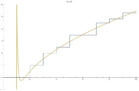

$$\psi^*(x) =\sum_{p^k \le x} \log p$$ enter image description here

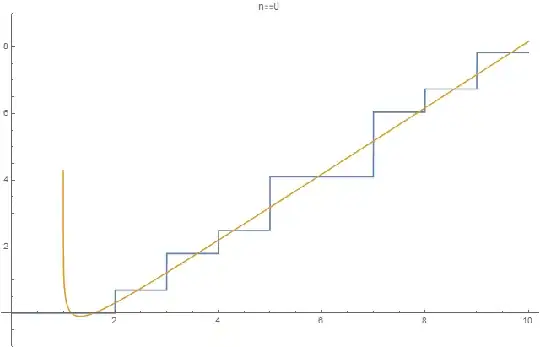

$$\Pi^*(x) = \sum_{p^k \le x} \frac{1}{k}$$ enter image description here
