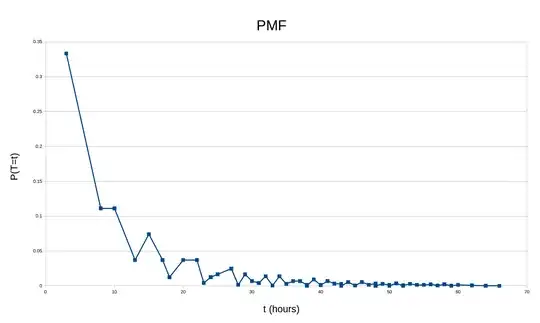

This is a different approach, using the expected time taken for the miner to pass through $n$ doors.
Let $n$ be the number of doors the miner opens and let $P(T=t)$ be the probability the miner takes $t$ hours to exit. For $n=3$, the sequence of doors the miner opens is one of $(2,2,1),(2,3,1),(3,2,1),(3,3,1)$. These sequences correspond to $P(5+5+3)=\frac{1}{3^3}$, $P(5+7+3)=\frac{2}{3^3}$ and $P(7+7+3)=\frac{1}{3^3}$. The numerator of the second probability is $2$ because there are $2$ ways to have $t=15$. The figure below is a graph of the PMF of P(t).
PMF graph
If the miner passes through $n$ doors, of which $k$ are door-$2$, then he will pass $n-1-k$ times through door-$3$. The $-1$ term accounts for him passing through door-$1$. Then, in general, $P(5k+7(n-1-k)+3)=\frac{1}{3^n}\binom{n-1}{k}$. This is because there is a $\frac{1}{3^n}$ probability of picking each sequence of doors, but $\binom{n-1}{k}$ ways to pick that sequence. The miner can pass through door-$2$ between $0$ and $n-1$ times, so $0\leq k\leq n-1$.
$\mathbb{E}[T]=\sum tP(t)$
At $n$, the expected value, $\mathbb{E}[T]$, is:
$$ \begin{aligned} \mathbb{E}[T]&=\sum _k tP(t) \\ &=\sum_{0\leq k\leq n-1}\frac{5k+7(n-1-k)+3}{3^n}\binom{n-1}{k} \\ &=\frac{1}{3^n}\left[(7n-4)\sum\binom{n-1}{k}-2\sum k\binom{n-1}{k}\right] \\ &=\frac{1}{3^n}\left[2^{n-1}(7n-4)-2^{n-1}(n-1)\right] \\ &=\frac{2^{n-1}(6n+3)}{3^n} \end{aligned} $$
Then, the expected value over all $n$ is:
$$ \begin{aligned} \mathbb{E}[T]&=\sum_{n\in\mathbb{Z^+}} \frac{2^{n-1}(6n+3)}{3^n} \\ &=15 \end{aligned} $$

    Minor pedantry: the independent variable, time, is discrete in this case. It might be better to present the pmf as a (normalized) histogram. At the very least, the segments connecting points seem inappropriate. Otherwise, I rather like this approach. – Xander Henderson Jul 03 '18 at 15:49
  • @Xander - Thanks for the constructive criticisms, I think you're probably right. I'll try to make a new figure when I next get the chance :) – Jam Jul 03 '18 at 16:56

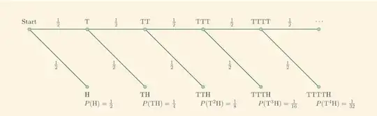

Consider a simpler example: you have a fair coin. You toss the coin over and over and over again. What is the expected number times that you will toss the coin before you get heads? Of course, it is possible that you will toss the coin infinitely many times and never ever get heads. On the other hand, it is also possible that you will get heads on the very first toss. Hopefully, your intuition is that it is extremely unlikely that you will have to toss the coin more than a few times before it comes up heads. We can summarize the whole process with a tree diagram:
The probability at each leaf is the product of all of the probabilities leading up to it (this is a result of independence; note that these kind of diagrams can often be useful for understanding conditioning). On the top row, we just keep tossing tails over and over and over again. The terminal outcomes all end with heads. Then \begin{align} \mathbb{E}[\text{number of tosses}] &= 1\cdot \mathrm{P}(\mathrm{H}) + 2\cdot \mathrm{P}(\mathrm{TH}) + 3\cdot \mathrm{P}(\mathrm{TTH}) + 4\cdot \mathrm{P}(\mathrm{TTTH}) + \dotsb \\ &= \frac{1}{2} + \frac{2}{4} + \frac{3}{8} + \frac{4}{16} + \dotsb \\ &= \sum_{n=1}^{\infty} \frac{n}{2^n} \\ &= 2. \end{align} Hence, on average, we can expect to toss the coin twice.
Notice that we can vastly simplify this picture by noting that if we first toss tails, then we go right back to the start. That gives us this picture:
Then \begin{align} \mathbb{E}[\text{number of tosses}] &= 1\cdot \mathrm{P}(\mathrm{H}) + (1+\mathbb{E}[\text{number of tosses}])\cdot \mathrm{P}(\mathrm{T}) \\ &= \frac{1}{2} + \frac{1+\mathbb{E}[\text{number of tosses}]}{2} \end{align} The $1+\mathbb{E}[\text{number of tosses}]$ comes from the fact that if we toss tails on the first coin toss, then we have already tossed the coin once, but everything else is as though we just started the process from the beginning. This can be phrased in terms of conditional probability, but I don't think that the extra notation will help much here. In any even, solving for the expected number of tosses, we get $$ \frac{1}{2} \mathbb{E}[\text{number of tosses}] = 1 \implies \mathbb{E}[\text{number of tosses}] = 2. $$
