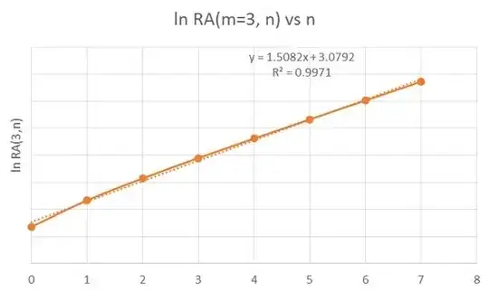

ln RA(3,n) vs n
If you run a fit of ln RA(m=3, n) vs n, you obtain slope of 1.5082 with intercept of 3.0792 with $R^2$ of 0.9971 Looks like the relationship is approximately 21.7*exp(1.5n)

  • So y ticks are 0, 2, 4, 6, 8, ... From n = 1 to 10 the # function calls are [106, 541, 2432, 10307, 42438, 172233, 693964, 2785999, 11164370, 44698325] (2) ln 541 = 6.29, (6) ln 172233 = 12.05, (7) ln 693964 = 13.45 – Arpad Horvath Mar 14 '23 at 11:55
