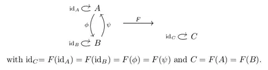

The example is as follows: Consider the following diagram: enter image description here
and take $A$ and $B$ to be objects of category $\mathcal{C}$. Let them be sets where $A$ has 3 elements and $B$ has 2 elements and let $\phi$ send these 3 elements to only one element of $B$ and let $\psi$ send the 2 elements of $B$ to one of the elements of $A$.
Now let $C$ be the object of category $\mathcal{C}_2$, let it also be a set with one element and let the functor $F$ send the objects and arrows as indicated below the diagram.
Is there already an error in this construction? If not, one can show that $F$ is fully faithful and essentially surjective:

Now I do not see which functor could be constructed to show the equivalence because if $G$ sends $C$ to $G(C)=A$, then $G(F(B))=A$ and $A$ is not isomorphic to $B$. The same holds if $G(C)=B=G(F(A))$.

A delayed answer, but it is perhaps good to set the record straight on this question. In short: yes, $F$ is an equivalence of categories and $A$ is indeed isomorphic to $B$.
In your answer, you seem to suggest that the morphism $\psi \circ \phi$ is different from $\operatorname{id}_A$. However, I don't think it is: the four arrows are probably the only four morphisms the category has and the composition of $\phi$ with $\psi$ should give the identity on $A$.
With this interpretation of the example, the functor $F$ is both essentially surjective and it is fully faithful, precisely because of the reasons you mention.
This is not a contradiction, because the functor $F$ is indeed an equivalence. There are two choices for an inverse $G$, of which one is the one you gave: $G(C) = A$, $G(\operatorname{id}_C) = \operatorname{id}_A$. As you point out, $G(F(B)) = A$. But note that $A$ is isomorphic to $B$ via $\phi: A \to B$ with inverse $\psi: B \to A$! So $G \circ F$ is naturally equivalent to the identity on the category $\mathcal{C}_1$! Also clearly $F \circ G$ is equal to the identity on $\mathcal{C}_2$, so $G$ is an inverse of $F$ and thus $F$ is an equivalence of categories.
