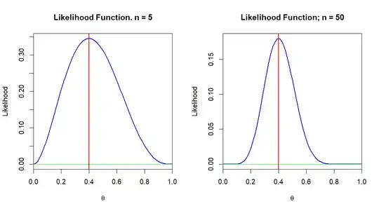

Consider the problem of estimating the success probability $\theta$ of the distribution $\mathsf{Binom}(n, \theta)$ using information from $n$ trials. The maximum likelihood estimator of $\theta$ is $\hat \theta = X/n,$ where $X$ is the observed number of successes.
The PDF of $X$ is $$f(x\,|\,\theta) = {n \choose x}\theta^x(1-\theta)^{n-x},$$ for $x = 0, 1, \dots, n.$ Given $n$ and $\theta,$ the PDF allows you to calculate $P(X = x).$
Viewed as a function of $\theta$ for observed $x$ this same relationship is known as the likelihood function. $$\ell(x\,|\,\theta) = {n \choose x}\theta^x(1-\theta)^{n-x} \propto \theta^x(1-\theta)^{n-x},$$ for $0 \le \theta\le 1.$ The symbol $\propto$ ("proportional to") indicates that for observed $x$ the constant factor ${n \choose x}$ has been omitted. Many authors take the point of view that the likelihood function is defined only 'up to a positive constant'. Then the maximum likelihood estimator (MLE) of $\theta$ is found by maximizing $\ell(x\,|\,\theta)$.
Suppose $n = 5$ and $x = 2.$ Then the MLE $\hat \theta = 0.4$ is the value of $\theta$ that maximizes the curve in the left panel of following figure. Also, if $n=50$ and $x = 20,$ then again the MLE $\hat \theta = 0.4.$
But there is more 'information' in 50 observations than in five, so the likelihood curve in the right panel has a 'sharper' maximum.
The second derivative of the curve near $\hat \theta = 0.4$ is greater on the right. Very roughly speaking, the Fisher information gives the expected curvature.
